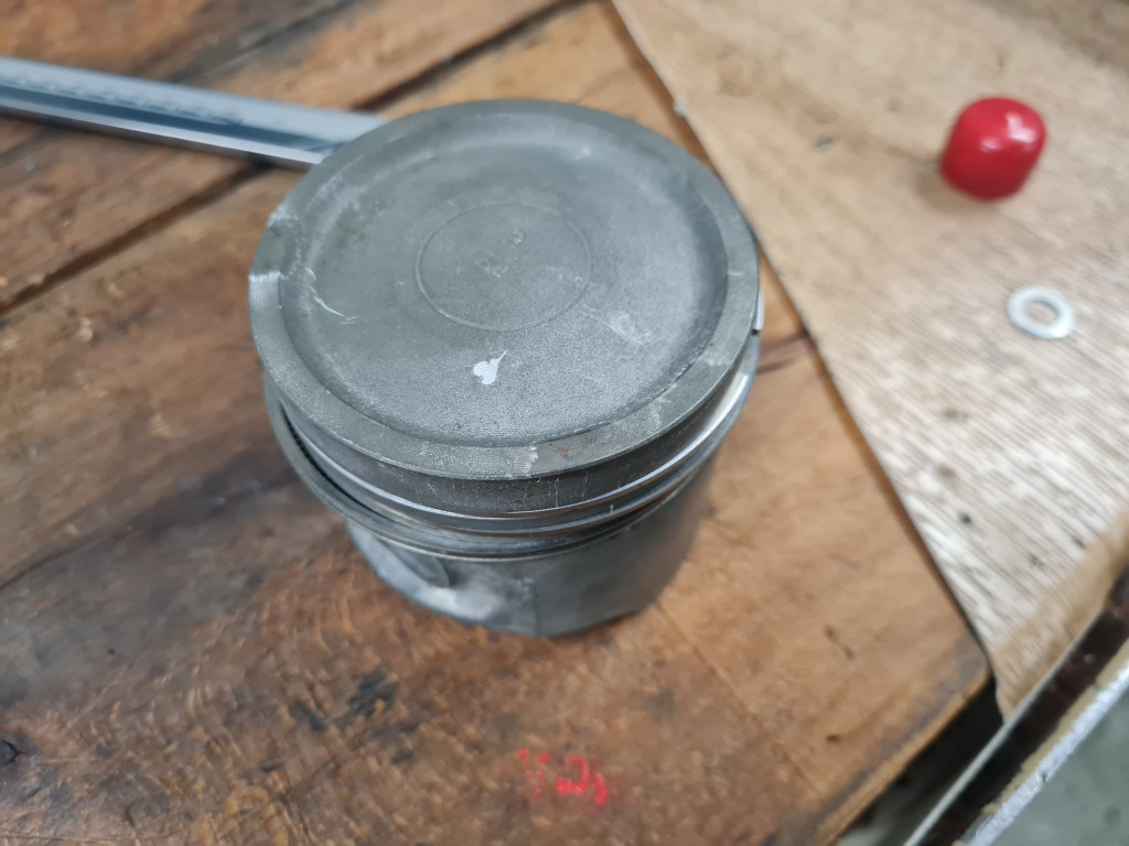

I got it, but what is the difference between XSI (K6B ?) and non XSI (KDX, KDY KFZ )1360cc engines piston? I did not find relevant info..
Re: Peugeot 106 Rallye white and Kenwood black
They have flat pistons compared to XSi.
Probably XSI piston than, because there is a hole on the top...
We made further investigation on the motor. Here are the coclusions:
The cylinder head is original. We measured the volume of the combustion chamber in cylinder head, it is ~30ccm. According to the homologation form of group N Rallye 1.3 the volume is 30.1ccm. We also measured the volume of the hole on the top of piston, it is ~5ccm. The distance between top of piston and gudgeon pin center line is 40.5mm.
From this data I calculated the compression ratio of the motor, and it is very far from original. ~8.6 instead of 10.6.
So I am not willing to repair it in this condition, we need to change something. There are a few options:
-Convert it back to original condition, than I should find crankshaft, connecting rods and pistons.
-Find other connecting rod - piston combination with 1.4 crankshaft. 1.4 parts can be found easily.
-Put a 1.6 crankshaft with actual piston and connecting rod. By calculation the capacity would be 1445ccm, and the compression ratio would be 11.5:1
Well, it is higher than the original Rallye, but we can use 100 octane number gasoline. And in amateur slalom race any modification is allowed.
What is your opinion? Can the TU5 1.6 crankshaft be fitted into Rallye block? Does anyone have experience?
Xsi piston looks like that :

Definitely not rallye/XSi piston.
